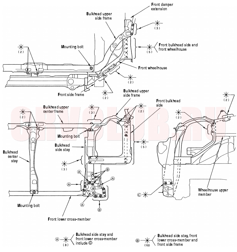

Mass Production Body Welding Diagram

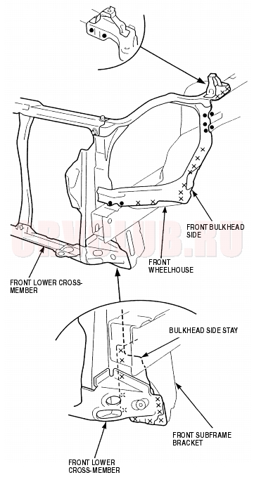

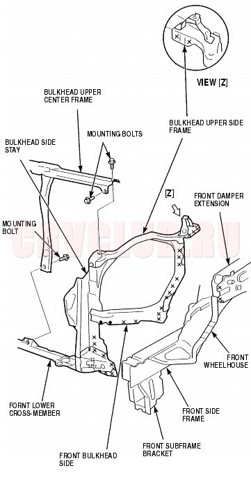

Removal 3-3
Installation3-3
  1. Set the new front bulkhead and wheelhouse upper extension into position, and measure the front compartment diagonally. Check the body dimensions (see section 4) .
  2. Tack weld the clamped position.
  3. Temporarily install the hood, front fender, headlight, and front bumper and check for differences in level and clearance.
  4. Do the main welding.
