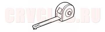

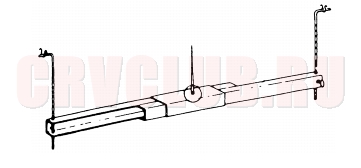

Measurement Equipment

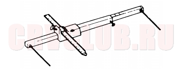

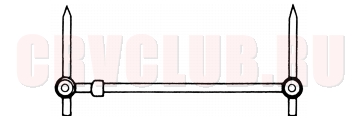

TRAM TRACKING GAUGE
FRAME CENTERING GAUGE
UNIVERSAL TRAM GAUGE
CONVEX TOOL

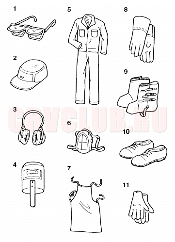

Protective Tools
OPERATOR:
Protective goggles
Protective apron
Cap
Welding glove
Ear plugs
Foot protector
Shield for eyes
Safety shoes
Overalls with long sleeves
Work glove
Dust-proof mask
Splatter guard

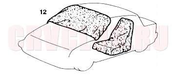

VEHICLE BODY:
Heat-resistant protective cover

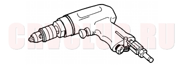

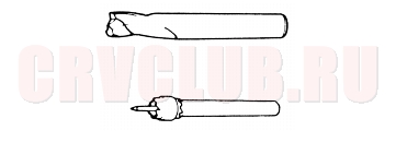

SPOT CUTTER
Install the spot cutter in the air drill, and drill a hole at the spot weld nugget and the plug to make the hole.
AIR DRILL
The rotation speed can be adjusted and an adequate hole opening can work.

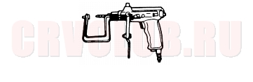

PRESSURE DRILL
The depth of the hole can be adjusted and only necessary plate thickness can puncture.
CENTER PUNCH
When an accurate hole opening is necessary.

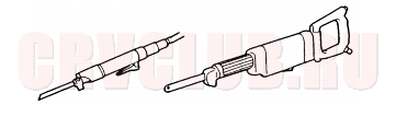

AIRSAW
Cut the outer panel.

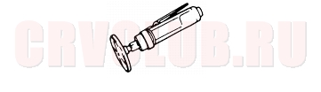

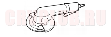

AIR CHUCK GRINDER
Detaching the MIG welding part and the panel can be cut by installing cut grinding wheel in air chuck grinder.

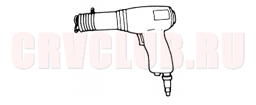

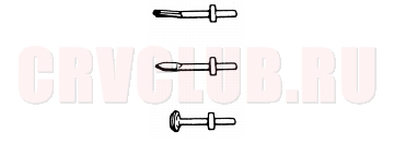

AIR IMPACT CUTTER
Cut the outer panel roughly.

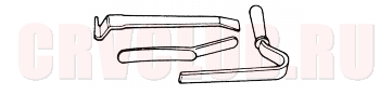

CHISEL SET
SPOT WELD CUTTER
Pry off the spot welded flange.

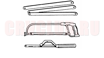

HANDSAW

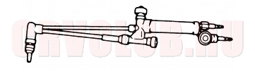

GAS CUTTER
ACETYLENE BURNER

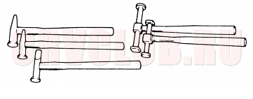

Skin Panel Shaping:

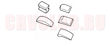

HAMMERS
DOLLIES
SPOONS

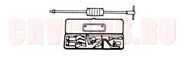

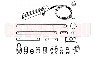

SLIDE HAMMER
BODY JACK
FRAME CORRECTOR

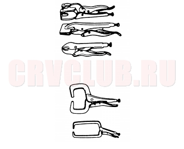

VICE-GRIPS
SCREW CLAMP
SCREW VICES

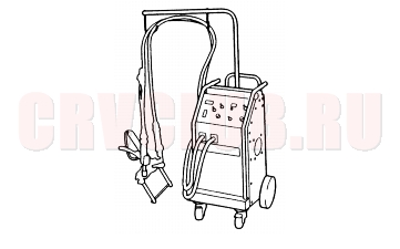

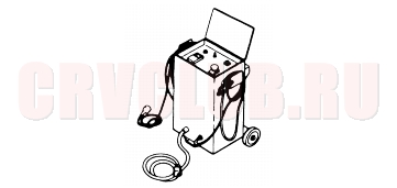

SPOT WELDER

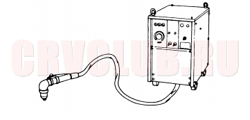

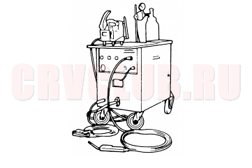

MIG WELDER

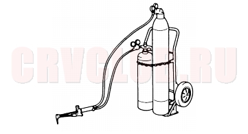

GAS WELDER

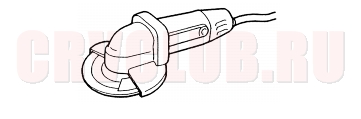

DISC GRINDER
Grinding of welded flange.

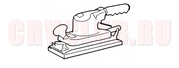

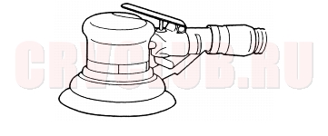

LONG ORBITAL SANDER
Sanding putty within the wide range and finish.
