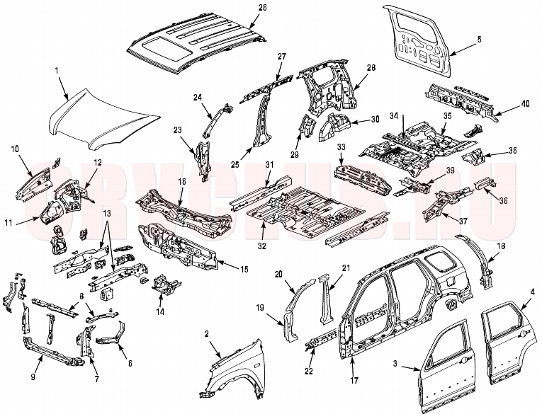

Body Construction 1-9
Sp: Steel plate Hss: High strength steel plate Zn: Zinc-plating
Hood (Hss, Zn)
22
Side Sill Reinforcement (Hss, Zn)
2
Front Fender (Sp, Zn)
23
Front Pillar Inner Lower (Hss, Zn)
3
Front Door (Hss, Zn)
24
Front Pillar Inner Upper (Hss)
4
Rear Door (Hss, Zn)
25
Center Inner Pillar (Hss)
5
Tailgate (Sp, Zn)
26
Roof Panel (Sp)
6
Bulkhead Side (Sp, Zn)
27
Roof Side Rail (Hss)
7
Bulkhead Side Stay (Sp, Zn)
28
Rear Inner Panel (Sp, Zn)
8
Bulkhead Upper Center Frame/Side Frame (Sp, Zn)
29
Wheel Arch Extension (Sp, Zn)
9
Front Lower Cross-member (Hss, Zn)
30
Rear Wheelhouse (Sp, Zn)
10
Wheelhouse Upper Member (Sp)
31
Inside Sill (Hss, Zn)
11
Front Wheelhouse (Sp, Zn)
32
Front Floor (Sp, Zn)
12
Damper Housing (Sp, Zn)
33
Middle Floor Cross-member (Hss, Zn)
13
Front Side Frame (Hss, Zn)
34
Rear Floor Upper Cross-member (Sp)
14
Side Frame Extension Rear/Front Side Outrigger (Hss, Zn)
35
Rear Floor (Sp, Zn)
15
Dashboard Lower (Sp, Zn)
36
Rear Floor Extension (Sp, Zn)
16
Dashboard Upper (Sp, Zn)
37
Rear Frame A (Sp, Zn)
17
Outer Panel (Sp, Zn)
38
Rear Frame B (Hss, Zn)
18
Rear Pillar Gutter (Sp, Zn)
39
Rear Floor Cross-member (Sp, Zn)
19
Front Pillar Lower Stiffener (Sp)
40
Rear Panel (Sp, Zn)
20
Front Pillar Upper Stiffener (Hss)
21
Center Pillar Stiffener (Sp)
