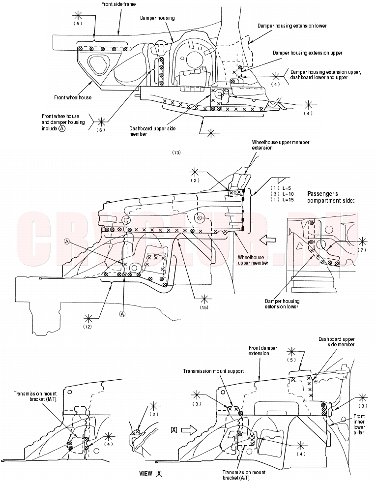

Mass Production Body Welding Diagram

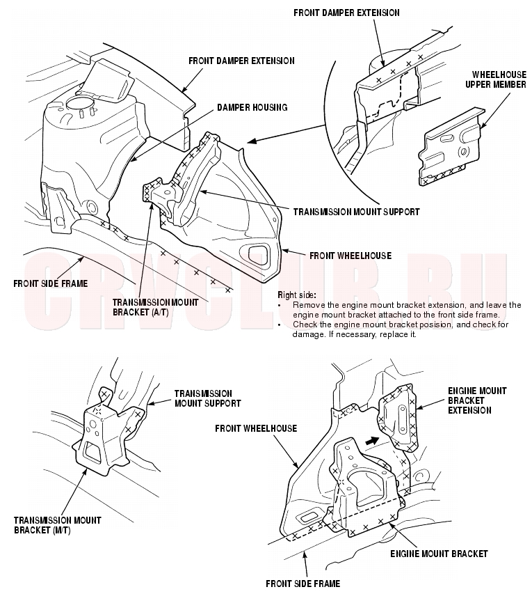

Removal
Cut and remove the wheelhouse upper member, and replace the front wheelhouse. When removing the front wheelhouse

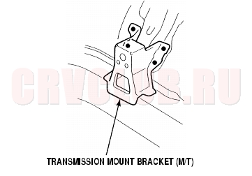

M/T: Leave the transmission mount bracket attached to the front side frame. A/T: When replacing the front wheelhouse, support the wheelhouse and transmission mount bracket as an assembly.

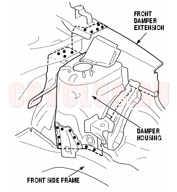

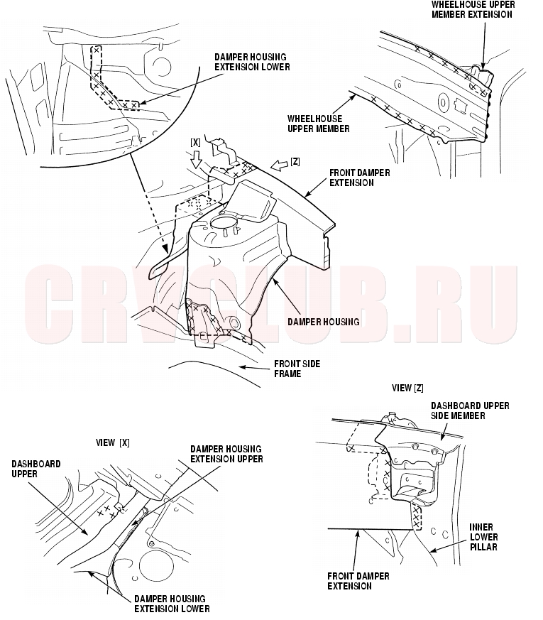

Check the damper housing position, and check for damage. If necessary, remove the Wheelhouse upper member, and replace the front damper extension, damper housing, and damper housing extension as an assembly.

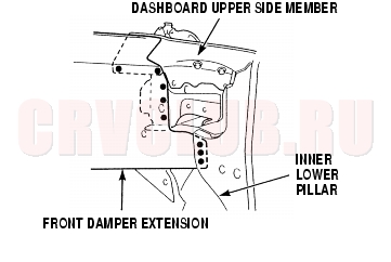

- Weld the damper housing and front side frame.
- Weld the front damper extension and dashboard upper side member.

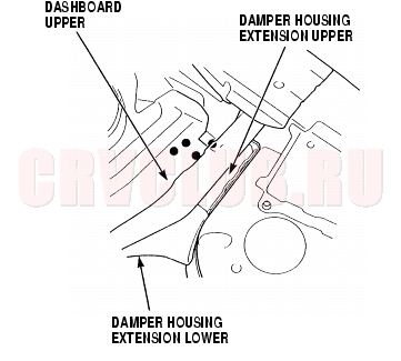

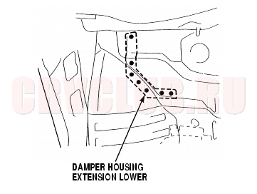

- From the passenger's compartment side, plug weld the holes in the dashboard lower, and damper housing extension lower.
- From the dashboard upper side, plug weld the holes in the damper housing extension upper.

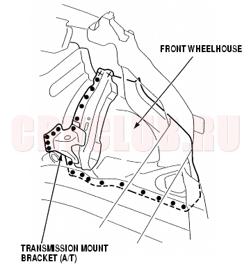

Weld the front wheelhouse, damper housing, and front side frame. Left side:
Right side:

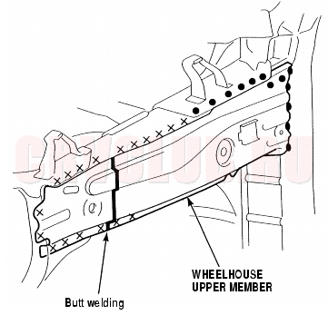

Weld the wheelhouse upper member.
