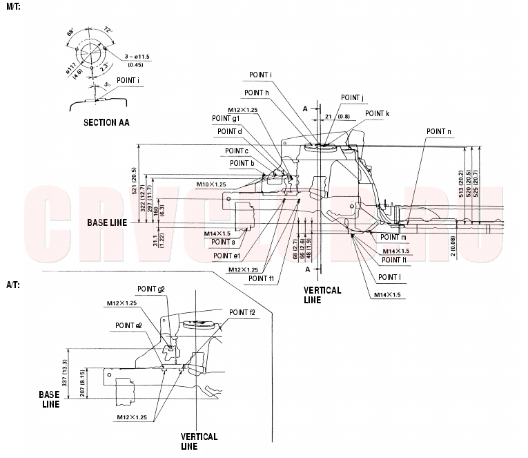

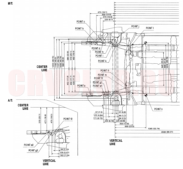

Frame Repair Chart4-8
Top View
| Unit: mm (in.)
Ø : Inner diameter
a
For subframe Ø 16 (0.63)
g2
For A/T transmission mount Ø 13 (0.51)
| b
For engine mount Ø 13 (0.51)
h
For damper mount Ø 11.5 (0.45)
| c
i
For damper center Ø 78 (3.07)
| d
j
| e1
For M/T transmission mount Ø 13 (0.51)
k
| e2
l
| f1
l1
| f2
m
Locating hole Ø 27.4 (1.08)
| g1
n
Locating hole Ø 50 (1.97)
| o
Locating hole Ø 25 (0.98)
t
Rear damper center Ø 68 (2.68)
| p
u
For rear cross beam Ø 15 (0.59)
| p1
u2
Locating hole Right side: Ø 13 (0.51)/Left side: Ø 15 (0.59)
| p2
Locating hole Ø 23 (0.91)
v
| q
For trailing arm Ø 14 (0.55)
w
| r
Locating hole Ø 20 (0.79)
x
| s

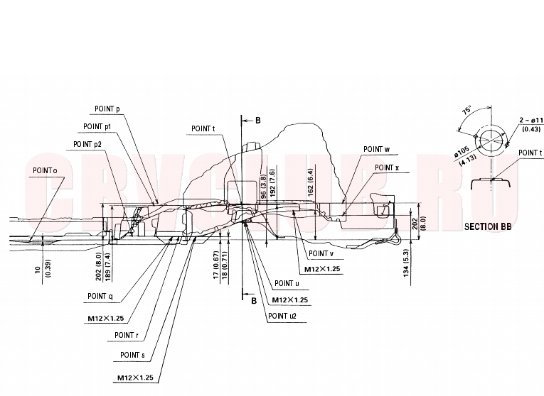

Frame Repair Chart (cont'd)4-11
Side View
| Unit: mm (in.)
Ø : Inner diameter
a
g2
| b
h
| c
i
| d
j
| e1
k
| e2
l
| f1
l1
| f2
m
| g1
n
| o
t
| p
u
| p1
u2
| p2
v
| q
w
| r
x
| s
