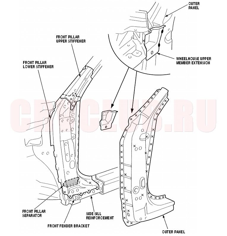

Removal
Remove the wheelhouse upper member extension, and cut and pry off the front pillar outer panel, and if necessary replace the front fender bracket. Check the front pillar lower stiffener position, and check for damage. Replace it if necessary. When replacing the front pillar lower stiffener, remove the front pillar separator, and glue the insulator at the separator mounted position. If necessary, replace the front fender bracket.

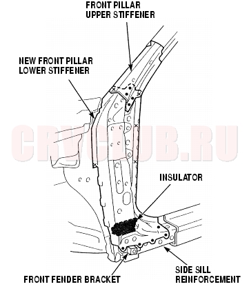

Installation

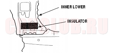

- Glue the insulator to the inner lower as shown.
- Insulator: P/N. 74416-SF1-000
- Adhesive: Cemedine 366, or equivalent
- Set the new front pillar lower stiffener and front fender bracket into position, and tack weld the clamped position.
- Cut the repair part (outer panel), and set it into position.
Clamp the repair part, and check the body dimensions (see section 4) .

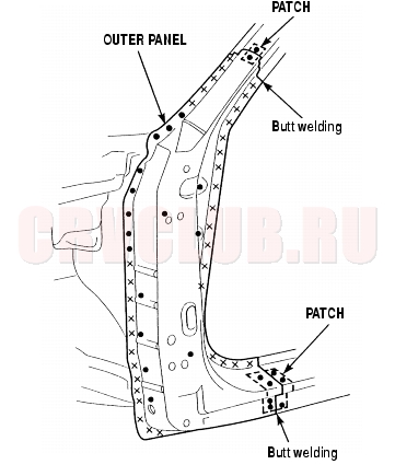

- Do the main welding.
- Attach a patch at the cut section of the front pillar and side sill outer panel, and plug weld them.

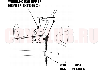

- Weld the wheelhouse upper member extension and upper member.
