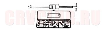

Repair Tools 2-12 |
Repair Tools 2-12

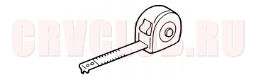

Measurement Equipment

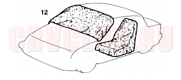

Protective Tools
OPERATOR:
1 7 2 8 3 9 4 10 5 11 6 12
Heat-resistant protective cover
2-13

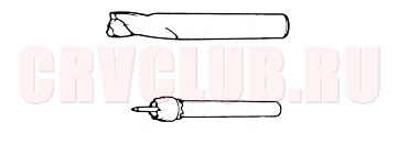

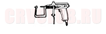

Install the spot cutter in the air drill, and drill a hole at the spot weld nugget and the plug to make the hole.
The rotation speed can be adjusted and an adequate hole opening can work.
The depth of the hole can be adjusted and only necessary plate thickness can puncture.
When an accurate hole opening is necessary.

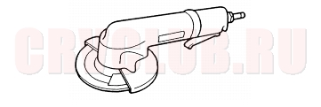

Cutting Tools
Cut the outer panel.

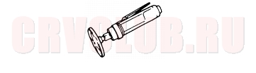

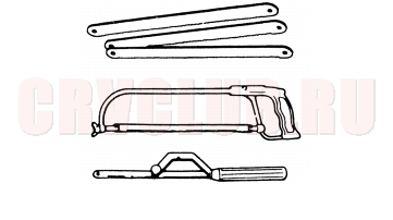

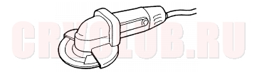

Detaching the MIG welding part and the panel can be cut by installing cut grinding wheel in air chuck grinder.
Cut the outer panel roughly.

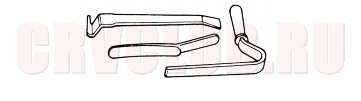

Pry off the spot welded flange.

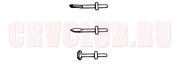

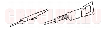

Cut the thick plate.
Peel off the undercoat.

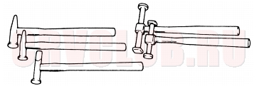

Shaping Tools
Edge preparation.

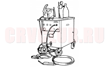

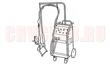

Welders

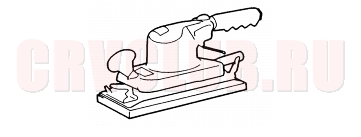

Sanding Tools
Sand off the paint film and use to finish the welded flange.
Finish off narrow welded flange.

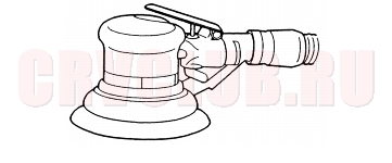

Featheredge and finish of putty.
Sanding putty within the wide range and finish.
