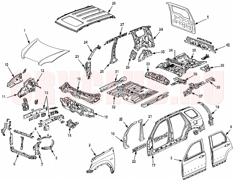

Body Construction 1-9
Sp: Steel plate Hss: High strength steel plate Zn: Zinc-plating
| 1
Hood (Hss, Zn)
22
Side Sill Reinforcement (Hss, Zn)
| 2
Front Fender (Sp, Zn)
23
Front Pillar Inner Lower (Hss, Zn)
| 3
Front Door (Hss, Zn)
24
Front Pillar Inner Upper (Hss)
| 4
Rear Door (Hss, Zn)
25
Center Inner Pillar (Hss)
| 5
Tailgate (Sp, Zn)
26
Roof Panel (Sp)
| 6
Bulkhead Side (Sp, Zn)
27
Roof Side Rail (Hss)
| 7
Bulkhead Side Stay (Sp, Zn)
28
Rear Inner Panel (Sp, Zn)
| 8
Bulkhead Upper Center Frame/Side Frame (Sp, Zn)
29
Wheel Arch Extension (Sp, Zn)
| 9
Front Lower Cross-member (Hss, Zn)
30
Rear Wheelhouse (Sp, Zn)
| 10
Wheelhouse Upper Member (Sp)
31
Inside Sill (Hss, Zn)
| 11
Front Wheelhouse (Sp, Zn)
32
Front Floor (Sp, Zn)
| 12
Damper Housing (Sp, Zn)
33
Middle Floor Cross-member (Hss, Zn)
| 13
Front Side Frame (Hss, Zn)
34
Rear Floor Upper Cross-member (Sp)
| 14
Side Frame Extension Rear/Front Side Outrigger (Hss, Zn)
35
Rear Floor (Sp, Zn)
| 15
Dashboard Lower (Sp, Zn)
36
Rear Floor Extension (Sp, Zn)
| 16
Dashboard Upper (Sp, Zn)
37
Rear Frame A (Sp, Zn)
| 17
Outer Panel (Sp, Zn)
38
Rear Frame B (Hss, Zn)
| 18
Rear Pillar Gutter (Sp, Zn)
39
Rear Floor Cross-member (Sp, Zn)
| 19
Front Pillar Lower Stiffener (Sp)
40
Rear Panel (Sp, Zn)
| 20
Front Pillar Upper Stiffener (Hss)
| 21
Center Pillar Stiffener (Sp)
