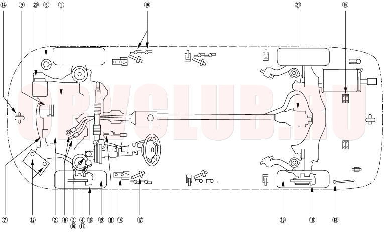

|  1
     Engine
     Always use fuel-efficient oil is that says ''API service SG, SH or SJ''
Recommended Engine Oil
   Engine oil viscosity for ambient temperature ranges
    |  2
     Manual Transmission
     Genuine Honda Manual Transmission Fluid (MTF)
 Always use genuine Honda MTF. Using motor oil can cause stiffer shifting
because it does contain the proper additives.
    |  Automatic Transmission
     Genuine Honda ATF-Z1
 Always use genuine Honda ATF-Z1. Using a non-Honda ATF can affect
shift quality.
    |  3
     Brake system (includes ABS line)
     Brake fluid DOT 3 or DOT 4
 We recommend genuine Honda Brake Fluid. Using a non-Honda brake
fluid can cause corrosion and decrease the life of the system.
    |  4
     Clutch line (manual transmission)
    |  5
     Power steering system
     Honda Power steering Fluid (V or ll)
 Always use Honda Power Steering Fluid. Using any other type of power
steering fluid or automatic transmission fluid can cause increased wear
and poor steering in cold weather.
    |  6
     Shift and select cable ends (manual transmission)
     Super High Temp Urea Grease (P/N 08798-9002)
    |  7
     Release fork (manual transmission)
    |  8
     Throttle cable end (dashboard lower panel hole)
     Silicon grease
    |  9
     Throttle cable end (throttle link)
     Multi-purpose grease
    |  10
     Brake master cylinder pushrod
    |  11
     Clutch master cylinder pushrod
    |  12
     Battery terminals
    |  13
     Fuel fill lid
    |  14
     Hood hinges and latch
     Honda White Lithium Grease
    |  15
     Tailgate hinges
    |  16
     Door hinges, upper and lower
    |  17
     Door opening detent
    |  18
     Brake caliper piston boot, caliper pins and boots
     Silicon grease
    |  19
     Brake line joints (front and rear wheelhouse)
     Rust preventives
    |  20
     Air conditioning compressor
     Compressor oil: DENSO ND-OIL8 (P/N 38897-PR7-003 or 38899-PR7-
A01) for refrigerant HFC-134a (R-134a)
    |  21
     Rear differential (4WD model)
     Genuine Honda DPSF
