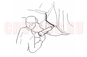

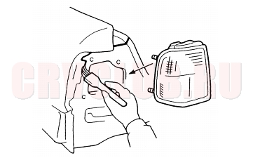

Note: Follow the sealer manufacturer's instructions.
- Clean the areas to be sealed with the was and grease remover.
- Wipe off any excess spot sealer with thinner. After the primer is sprayed, sealer will fill to the area where spot sealer was wiped off.
- Make sure you can see the sealant when the sealed part is in its proper location. Refer to the page 5-3 through page 5-7 of this manual.
- Finish sealing the engine compartment, the door opening, and the hatch gutter. Wipe off the excess sealer.
- Apply sealer on any area that replacement part will cover. Smooth the sealer with a brush if necessary.

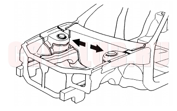

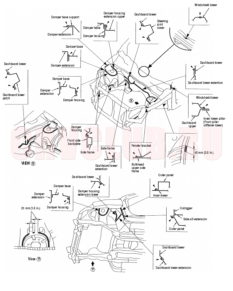

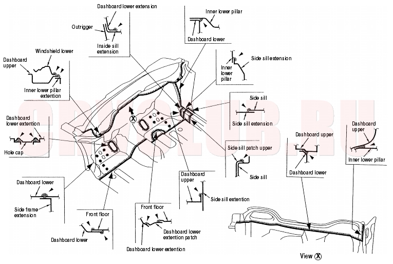

Engine Compartment, Front Wheelhouse, and Damper Housing
Cross Section of Body and Sealants (cont'd)5-4

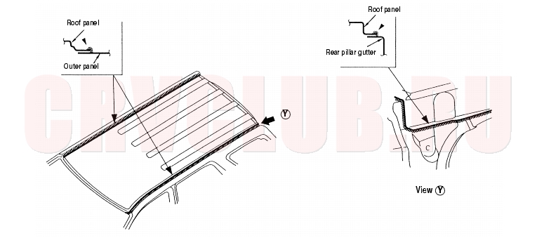

Dashboard Upper, Dashboard Lower, and Roof Panel
5-5

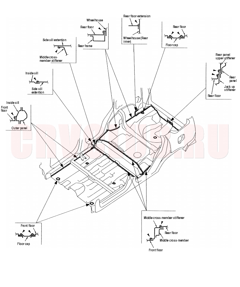

Front Floor and Rear Floor
Cross Section of Body and Sealants (cont'd)5-6

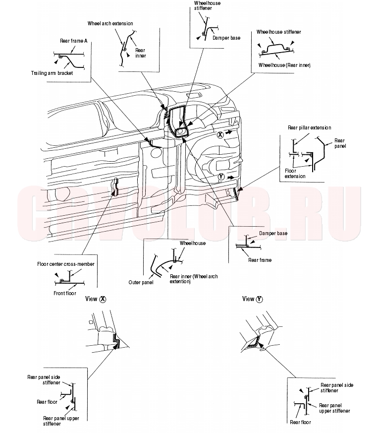

Rear Side Outer Panel, and Rear Panel
5-7
Under Floor, and Rear Wheelhouse
