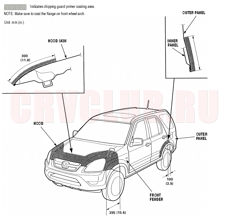

The soft chipping guard primer coat is applied over the E.D. (Electrostatically Deposited) primer. It is followed by guide coating and top coating. The soft chipping guard primer produces a smooth surface when dry. It should be sprayed so the thickness of the protective film is 20 microns. Basis Rules for Repairing a Soft Chipping Guard Primer Coat:
Soft chipping guard primer coat is then applied to the most susceptible area (see page 5-11) . Spray the primer surface (2-part urethane primer surfacer) on the soft chipping guard primer coating areas when you replaced parts using soft chipping guard primer coat.

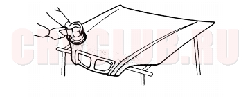

- Sanding the replacement part.
- NOTE:
- Do not oversand the edges or corners of the part.
- Do not expose base metal.
Use a double action sander and #400 disc sandpaper.

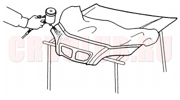

- Spraying primer surfacer
- Sprayer about 4 to 5 coats to get 20 microns of thickness. One coat deposits about 5 to 7 microns.
- Do not try to cover the surface with one heavy coat. Apply several thin coats is recommended.
- Use a 2-part urethane primer surface and a spray gun.
- Mix the primer surfacer with the additive and solvent, and in the correct ratio.
- Follow the primer surfacer manufacturer's instructions.
