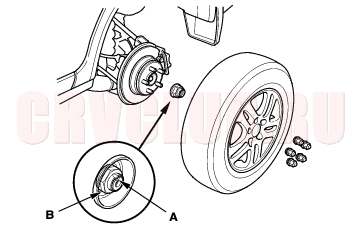

- Lift up the locking tab (A) on the spindle nut (B), then remove the nut.

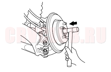

- Remove the rear driveshaft outboard joint from the trailing arm and rear hub using a plastic hammer or a puller if necessary.

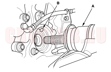

Be careful not to damage the ABS wheel sensor (B). Pull on the outer joint. Do not pull on the driveshaft because the joint may come apart.
