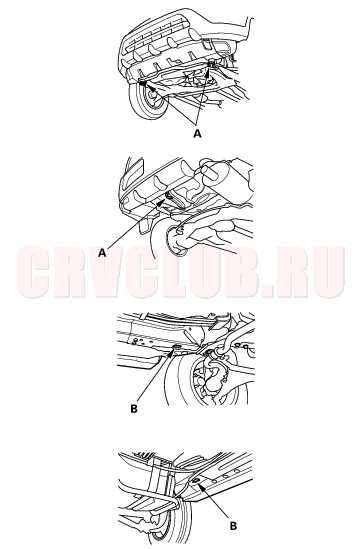

To accommodate flat-bed equipment, the vehicle is equipped with towing hooks (A) and tie down hook slots (B).
The towing hooks can be used with a winch to pull the vehicle onto the truck, and the tie down hook slots can be used to secure the vehicle to the truck.
