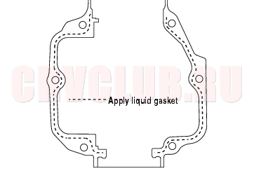

- Remove the six mounting bolts in a crisscross pattern in several steps, then remove the differential housing assembly (A) and oil seals (B).
- Remove the dirt and oil from the sealing surfaces. Apply liquid gasket (P/N08C70-K0234M) to the sealing surface. Be sure to seal the entire circumference of the bolt holes to prevent oil leakage.
- NOTE:
- If 5 minutes have passed after applying liquid gasket, reapply it and assemble the housings.
- Allow it to cure at least 20 minutes after assembly before filling the differential with fluid.
- Install the differential housing assembly (A), then torque the six mounting bolts (B) in a crisscross pattern in several steps.
