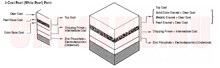

- Intermediate coat
- The intermediate coat is applied to the prepared surface for further protection against damage.
- Top Coat
- Enamel paint and either polyester or acrylic resin paint are used in the top coat for higher solidity, smoothness, brightness, and weather resistance.

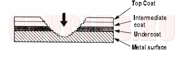

Sectional View of Paint Coats:

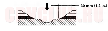

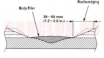

- Featheredging
- NOTE:
- The paint film damaged area should be sanded flat and smooth.
- If this is not done correctly the end results will not be acceptable.

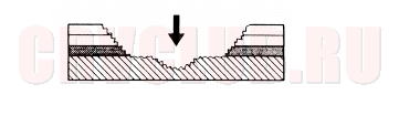

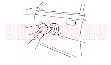

Damage to metal surface:
Sand the damaged area flat and smooth.
Use the disc sander and #60~#80 disc paper.
Use the double action sander and #60~#80 disc paper.
Sand the area larger than the damaged area.
If a double action sander is not available, use a rubber pad and wet or dry sandpaper.
Use the flexible block and #280, #340, #400, #600 sandpaper.

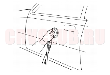

Damage to undercoat, intermediate coat and top coat:
Sand the damage area flat and smooth
Use the double action sander and #180~#240~#320 disc paper.

Treatment of Metal Surface

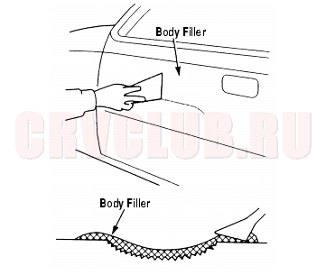

- Filling / drying
- Small cracks or pinholes in the sheet metal should be repaired with a body filler and sanded flat and smooth.
- Use the 2-part polyester resin putty.

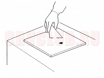

- Mix the putty with the hardener in the correct ratio.
- Follow the body filler manufacturer's instructions.
- Mix the body filler and hardener quickly.
- Apply the body filler in several thin coats, without air bubbles.
- Do not try to cover the surface with one heavy coat.
- Apply the body filler over the damaged area with a putty knife using light pressure.
- After applying the body filler, allow 5 to 6 minutes of normal drying time, then force dry it with infrared lamps or other industrial dryer at 122°F (0°C)~140°F (60°C).
- NOTE: Follow the body filler manufacturer's instructions for drying time.

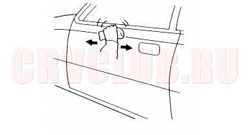

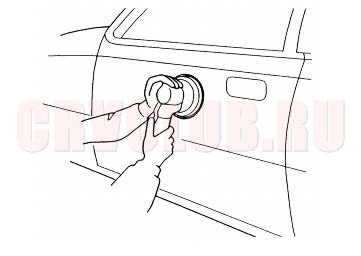

- Polishing
- The body filler is dry a white mark appears when the surface is scratched with your finger nail.

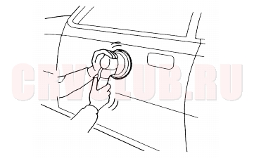

- Throughly sand the body filler surface
- Sand the surface evenly, particularly the area that was filled.
6-7
Featheredge the paint coat. Sand the body filler surface until the proper dimension are met.
Use the double action sander and #240~#320~#400 disc papers.

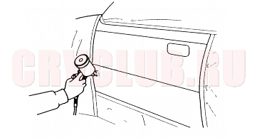

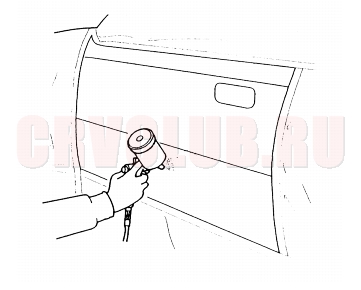

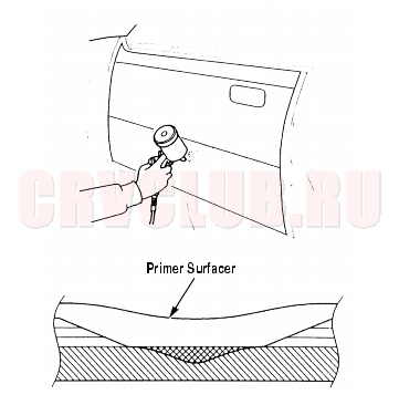

- Spraying the primer surfacer
- Spray the primer surfacer over a wider area than the body filler and the exposed surface of the paint film.
- Spray 2 to 3 coats to get 30 microns of thickness.
- Use the 2-part urethane primer surfacer and a spray gun.
- Mix the primer surfacer with the additive and solvent, and in the correct ratio.
- Follow the primer surfacer manufacturer's instructions.

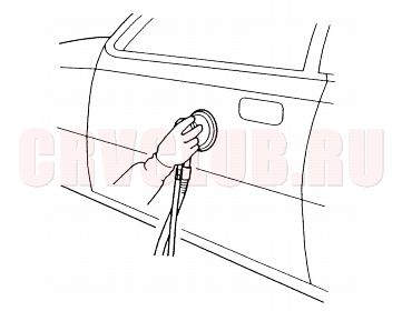

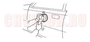

- Polishing
- Check that the primer surfacer has dried thoroughly, then sand the primer surfacer.
Use the double action sander and #320~#400~#600 disc papers.

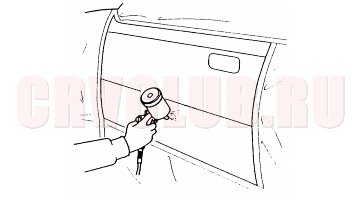

- Spraying top coat enamel
- Spray the top coat enamel over the surface until the primer surfacer is fully covered.
- NOTE: For the 3-coat pearl paint, spray the color base over the surface.
- Use the 2-part polyester urethane top coat enamel and a spray gun.
- Mix the top coat enamel with the additive and solvent, and in the correct ratio.
- Follow the top coat manufacturer's instructions.
