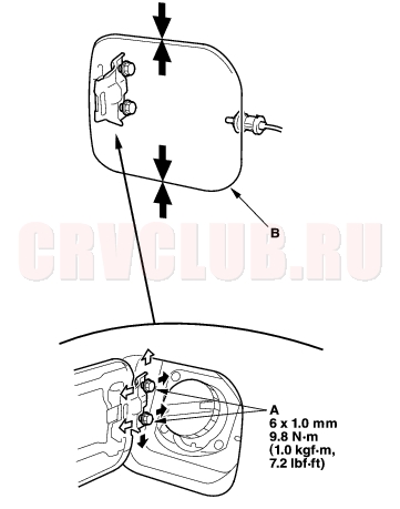

Adjustment
- Slightly loosen the hinge mounting bolts (A).
- Adjust the fuel fill door (B) in or out until it's flush with the body, and up or down as necessary to equalize the gaps.
- Tighten the hinge mounting bolts.
- Check that the fuel fill door opens properly and locks securely, and check that the rear of the door is flush with the body.

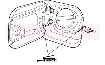

- Grease each location indicated by the arrows.
