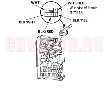

- Remove the dashboard lower cover (see page 20-88) .
- Disconnect connector A (5P) from the under-dash fuse/relay box.

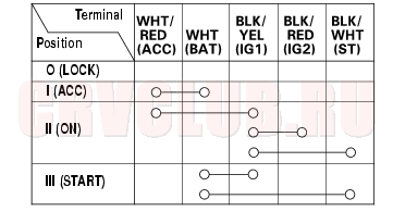

- Check for continuity between the terminals in each switch position according to the table.
- If the continuity checks do not agree with the table, replace the steering lock assembly (see page 17-27) .
