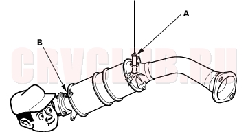

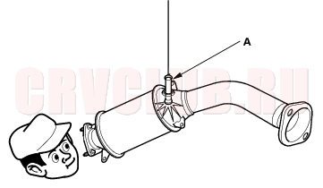

If excessive exhaust system back-pressure is suspected, remove the TWC from the vehicle.
Using a flashlight (A) and plug (B) (KG, KS, KE, KR, KU, KZ, FO, KQ models) make a visual check for plugging, melting or cracking of the catalyst.
Replace the TWC if any of the visible area is damaged or plugged.
KG, KS, KE, KR, KU, KZ, FO, KQ models:
KN, KM, KY, MA, PH, IN, KK models:

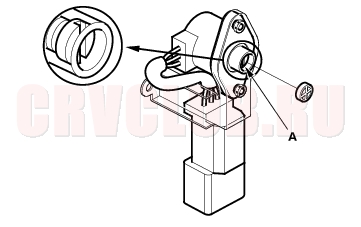

Without TWC model, adjust by turning the adjusting screw (A) of the IMA.
With TWC model, see DTC troubleshooting index.If unable to obtain a CO reading of specified % by this procedure, check the tune-up condition.
